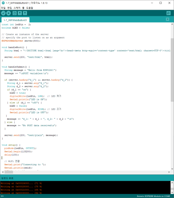

아래는 아두이노 전체 소스코드 입니다.
/* ip로 접속 버튼 핸들링 */
#include <ESP8266WiFi.h>
#include <ESP8266WebServer.h>
const char* ssid = "와이파이명";
const char* password = "와이파이비밀번호";
const int ledPin =  2;
boolean bLED = false;
// Create an instance of the server
// specify the port to listen on as an argument
ESP8266WebServer server(800);    // 일반적인 웹포트는 80입니다.
void handleRoot() {
  String html = "<!DOCTYPE html><html lang='ko'><head><meta http-equiv='content-type' content='text/html; charset=UTF-8'><title>ESP8266 :: WebServer</title><script src='https://cdnjs.cloudflare.com/ajax/libs/jquery/3.3.1/jquery.min.js'></script><link rel='stylesheet' type='text/css' href='../../../Arduino/main.css'></head><body><script type='text/javascript' src='http://code.jquery.com/jquery-3.5.1.min.js'></script><div class='container'><div class='inner'><div class='content'><form id='join_form' class='form btn_fixed' action='/api' method='POST'><div class='form_content'><div class='form_section'><div class='check_terms'><div class='check_wrap'><input type='checkbox' id='chk_all' name='chk_all' class='blind' checked='checked'><label for='chk_all'><span class='text check_all'>전체 켜기</span></label></div></div><ul class='terms_list'><li class='terms_item'><div class='check_terms'><div class='check_wrap'><input type='checkbox' id='d_1' class='blind' checked='checked'><label for='d_1'><em class='option point'>Device 1</em><div class='text_wrap'><span class='text'>Device 1</span></div></label></div></div></li><li class='terms_item'><div class='check_terms'><div class='check_wrap'><input id='d_2' name='d_2' type='checkbox' checked='checked'><label for='d_2'><em class='option point'>Device 2</em><div class='text_wrap'><span class='text'>Device 2</span></div></label></div></div></li><li class='terms_item'><div class='check_terms'><div class='check_wrap'><input type='checkbox' id='d_3' name='d_3' checked='checked'><label for='d_3'><em class='option'>Device 3</em><span class='text'>Device 3</span></label></div></div></li><li class='terms_item'><div class='check_terms'><div class='check_wrap'><input type='checkbox' id='d_4' name='d_4' checked='checked'><label for='d_4'><em class='option'>Device 4</em><div class='text_wrap'><span class='text'>Device 4</span></div></label></div></div></li><li class='terms_item'><div class='check_terms'><div class='check_wrap'><input type='checkbox' id='d_5' name='d_5' checked='checked'><label for='d_5'><em class='option'>Device 5</em><div class='text_wrap'><span class='text'>Device 5</span></div></label></div></div></li></ul></div></div><div class='btn_submit_wrap'><button type='button' id='submit' class='btn_submit'>적용</button></div></form></div><p id='message'></p></div></div><script src='../../../Arduino/main.js'></script></body></html>";
  server.send(200, "text/html", html);
void handleSubmit() {
  String message = "Hello from ESP8266!";
  message += "\nPOST variables:\n";
  if (server.hasArg("d_1") && server.hasArg("d_2")) {
    String d_1 = server.arg("d_1");
    String d_2 = server.arg("d_2");
    if (d_1 == "on") {
      bLED = true;
      digitalWrite(ledPin, LOW);  // LED 켜기
      Serial.println("LED is ON");
    } else if (d_1 == "off") {
      bLED = false;
      digitalWrite(ledPin, HIGH); // LED 끄기
      Serial.println("LED is OFF");
    message += "d_1: " + d_1 + ", d_2: " + d_2 + "\n";
  } else {
    message += "No POST data received\n";
  server.send(200, "text/plain", message);
void setup() {
  pinMode(ledPin, OUTPUT);
  Serial.begin(115200);
  delay(100);
  // WiFi 연결
  Serial.print("Connecting to ");
  Serial.println(ssid);
  WiFi.begin(ssid, password);
  while (WiFi.status() != WL_CONNECTED) {
    delay(500);
    Serial.print(".");
  Serial.println("");
  Serial.println("WiFi connected");
  Serial.print("IP address: ");
  Serial.println(WiFi.localIP());
  // 핸들러 등록
  server.on("/", HTTP_GET, handleRoot);    // 루트 페이지 처리
  server.on("/api", HTTP_POST, handleSubmit); // POST 처리
  // 웹 서버 시작
  server.begin();
  Serial.println("HTTP server started");
void loop() {
  // 클라이언트 요청 처리
  server.handleClient();
  // 시리얼 데이터 수신 처리
  if (Serial.available() >= 4) {
    // 시리얼에서 4바이트 읽기
    byte data[4];
    for (int i = 0; i < 4; i++) {
      data[i] = Serial.read();
    // 데이터 확인 및 처리
    if (data[0] == 241 && data[1] == 123 && data[3] == 242) {
      if (data[2] == 1) {
        bLED = true;
        Serial.println("Received: 241,123,1,242 - LED is ON");
      } else if (data[2] == 0) {
        bLED = false;
        Serial.println("Received: 241,123,0,242 - LED is OFF");

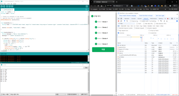

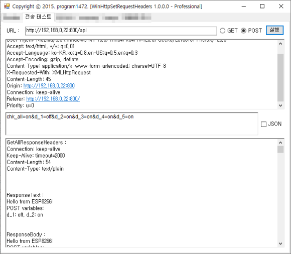

ESP8266 에 접속해서 테스트 해봤습니다
시리얼로 에코찍어서 상태도 확인했습니다.
역시 동작 잘 합니다
